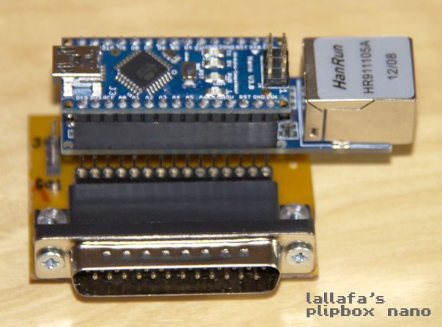

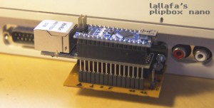

   Herhangi bir amiganın paralel portuna takarak kullanabiliyorsunuz.Amiga 500 içinde  olur.Aca500 birde aca1230 olursa dahada hızlı olur.Aşağıda hız benchmarkları var. Kahkaha
Here are some performance numbers:
    Amiga 500 + ACA500:
        Parallel Transfer: 175.39 rx/201.11 tx KB/s
        Ethernet Transfer: 314.27 KB/s
        Bridge (Internal Device Loopback): 102.65 KB/s
        Bridge (SANA-II API Loopback): 92.88 KB/s
        Bridge (TCP/IP stack Loopback): 71.81 KB/s
    Amiga 500 + ACA500 + ACA1230/33
        Parallel Transfer: 234.36 rx/234.80 tx KB/s
        Ethernet Transfer: 314.05 KB/s
        Bridge (Internal Device Loopback): 127.27 KB/s
        Bridge (SANA-II API Loopback): 123.68 KB/s
        Bridge (TCP/IP stack Loopback): 114.38 KB/s
http://lallafa.de/blog/amiga-projects/plipbox/plipbox-hardware/
